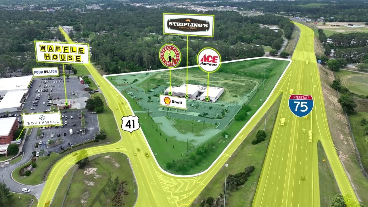

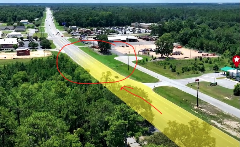

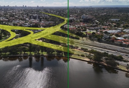

continuing with my quest of learning Fusion, I’ve come up with another challenge. I’m trying to recreate the yellow strips that paint over the major roads of the following videos in one of my drone videos. (these guys made them in AE).
I’ve tried using a background node with different masks but didn’t work. I’m thinking camera tracking but I’m not so sure how to implement it, same with planar tracker.
Here’s the drone orbit of mine where I want to apply it. The two major roads crossing. :slight_smile:

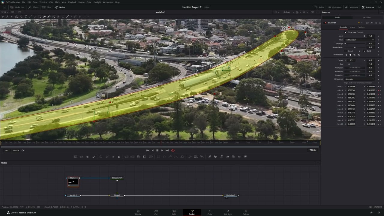

Here is what I would do.
Wow!! I can’t believe I went researching into the blackmagic forum and reddit and all I got was how hard and complex that effect is and how it was still way out of my league. I was almost fully discouraged until you came up with this quite simple solution without complex 3D camera tracking techniques. Thank you so much for your generosity Jay. I can’t wait for the day I’m knowledgeable enough to give back.

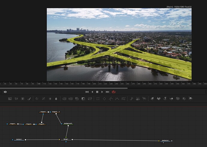

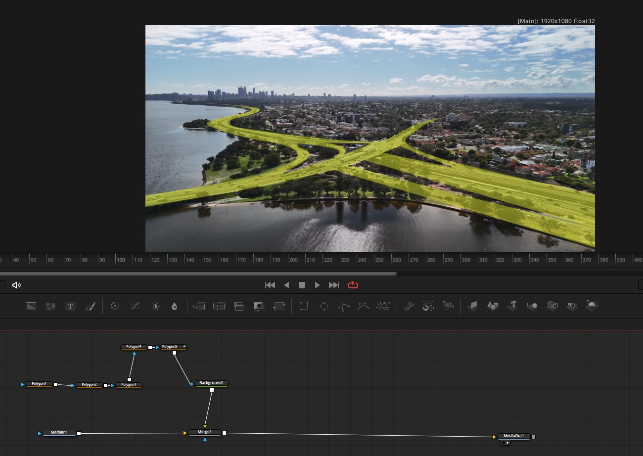

It’s almost midnight here and I just couldn’t get to sleep. I started working on it. This is how it looks. I haven’t got to animating yet, and I might be making things a bit more complicated by making 1 mask for the entire thing plus all the individual cutouts. I wonder if there’s away to have onlly one cutout node instead of 1 per cut out. Anyway, here’s my progress. I’m looking forward to moving forward :slight_smile:
Try using the MultiPoly node.

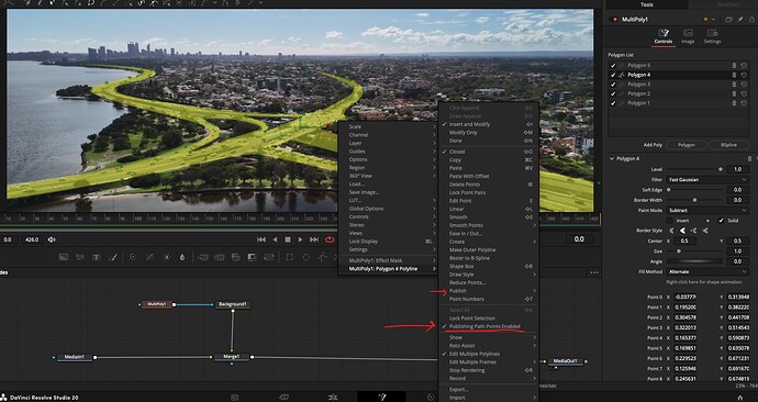

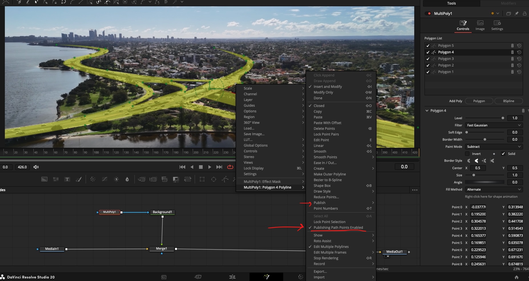

Alright, so I went ahead and tried the MultiPoly tool. It all went great until I realised that once finished, I couldn’t find “Publish” to Publish the points to animate. After a looot of playing around I found the solution so I wanted to share it here for those trying this. (I’m sure you already know this Jay).
Basically, I noticed that for every Polygon within the MultiPoly, you have to first click on “Publshing Path Points Enabled”. Once that is set, you will see “Publish” appear in the menu.
It is important to note that when you publish the points of mulitple polys, they will all add to the same one long long list! You won’t find them separately within each polyline. It can make things a bit confusing.
Here’s the screenshot for you guys to see. Hope this helps :slight_smile:

A bit of an update. Something really weird happens with the MultiPoly node. As you can see in the last screenshot I posted, I had all the points published ready for animation. However, I decided to wait till today for it so I closed the file.
Today, when I re opened the file, the list of all published points in the inspector (the one you see in the screenshot) was gone with no way whatsoever to bring it back. Publish them again wasn’t possible because the items for it in the menu were gone (those indicated in red in my previous screenshot).
So I think the only way to do this is to have all polygons in different nodes like in my first attempt, unless anyone knows why the bloody published points disappear when you close and open the file again and how to bring them back. This is so awkward

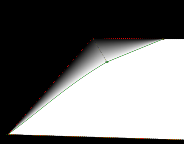

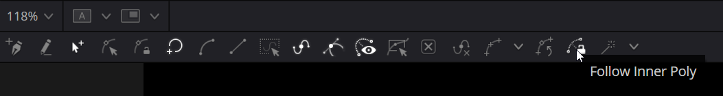

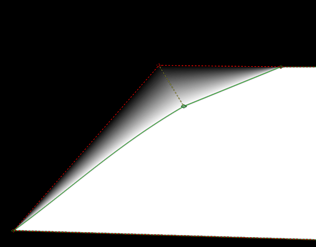

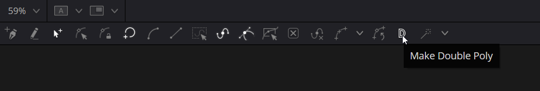

You have two options.
1.Easiest and what I would normally do. Just add another mask node any of them in line with your masks adjust the soft edge controls then turn the paint mode to subtract.
2.Next option would be to use double poly
When you have double poly enabled you will see diamond shapes on each of the polygon points. You can click and drag them to make the mask blend at the point.
Just make sure you keep follow inner poly on so all of your tracking/animation will effect this blend.
